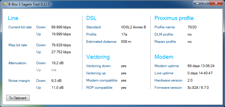

1ste
{"reply":{"uid":0,"id":1,"error":{"code":16777216,"description":"Ok"},"actions":[{"uid":1,"id":0,"error":{"code":16777238,"description":"Applied"},"callbacks":[{"uid":1,"result":{"code":16777238,"description":"Applied"},"xpath":"Device\/DSL\/Lines\/Line[@uid='1']\/Status","parameters":{"value":"UP",}}]}],"events":[]}}
2de
{"reply":{"uid":0,"id":2,"error":{"code":16777236,"description":"Action error"},"actions":[{"uid":1,"id":0,"error":{"code":16777242,"description":"Unknown path"},"callbacks":[]}],"events":[]}}
Normaal
B-Box 3 Sagem Tool v0.12.6
Upstream current bit rate:     19 999 kbps
Downstream max bit rate:       79 829 kbps
Upstream max bit rate:         26 127 kbps
Downstream attenuation:        19,2 dB
Downstream noise margin:       9,3 dB
Upstream noise margin:         9,7 dB
Estimated distance:            508 m
Proximus profile name:         70/20

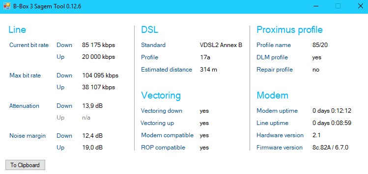

TiTanium schreef:EDIT:
Downstream current bit rate:   85 175 kbps
Upstream current bit rate:     20 000 kbps
Downstream max bit rate:       104 095 kbps
Upstream max bit rate:         38 107 kbps
Al eens een TBF geprobeerd?
Dan kom je waarschijnlijk op 85/30 (als je in zone 1 zit)
ik zit in zone 1 maar met een cap op 15 ben ik er niets mee :p
