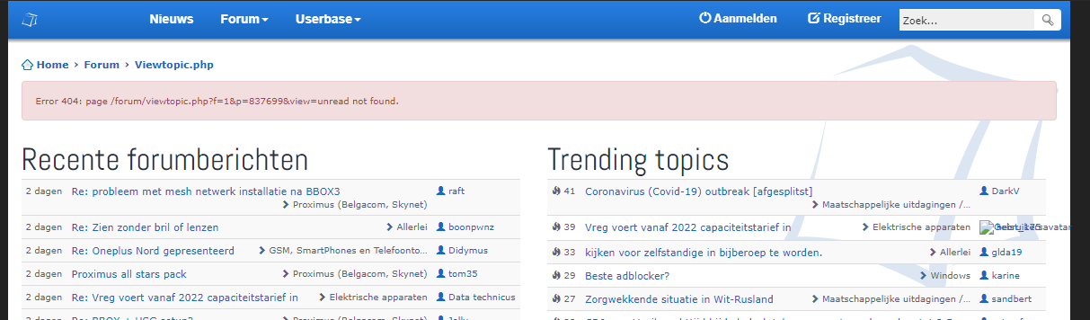

Cool! Al beter, maar nog niet helemaal.
Het forum werkt nog niet op deze manier, terwijl /forum/viewtopic.php echt wel bestaat...
init rewrite engine with requested uri /forum/viewtopic.php
applying pattern '^(.*)$' to uri '/forum/viewtopic.php'
RewriteCond: input='f=43&p=837700&view=unread' pattern='mosConfig_[a-zA-Z_]{1,21}(=|\\%3D)' => not-matched
RewriteCond: input='f=43&p=837700&view=unread' pattern='base64_encode.*\\(.*\\)' => not-matched
RewriteCond: input='f=43&p=837700&view=unread' pattern='(\\<|%3C).*script.*(\\>|%3E)' [NC] => not-matched
RewriteCond: input='f=43&p=837700&view=unread' pattern='GLOBALS(=|\\[|\\%[0-9A-Z]{0,2})' => not-matched
RewriteCond: input='f=43&p=837700&view=unread' pattern='_REQUEST(=|\\[|\\%[0-9A-Z]{0,2})' => not-matched
RewriteCond: input='/forum/viewtopic.php' pattern='!-f' => matched
RewriteCond: input='/forum/viewtopic.php' pattern='!-d' => matched
RewriteCond: input='/forum/viewtopic.php' pattern='!^/index.php' => matched
RewriteCond: input='/forum/viewtopic.php' pattern='(/|\\.php|\\.html|\\.htm|\\.feed|\\.pdf|\\.raw|/[^.]*)$' [NC] => matched
rewrite '/forum/viewtopic.php' -> '/index.php?/forum/viewtopic.php'
split uri=/index.php?/forum/viewtopic.php -> uri=/index.php, args=/forum/viewtopic.php&f=43&p=837700&view=unread
local path result: /index.php
prefixed with document_root to /var/www/userbase.be/index.php
go-ahead with /var/www/userbase.be/index.php [OK]

Splitter schreef:RewriteCond: input='/forum/viewtopic.php' pattern='(/|\\.php|\\.html|\\.htm|\\.feed|\\.pdf|\\.raw|/[^.]*)$' [NC] => matched
je rewriterule RewriteCond %{REQUEST_URI} (/|\.php|\.html|\.htm|\.feed|\.pdf|\.raw|/[^.]*)$ [NC] moet eruit.
Als ik die in commentaar zet heb ik zelfde gedrag én werkten de images en CSS niet meer, want die worden ook rewritten naar index.php.
Het is overigens niet enkel die viewtopic.php die het niet doet, maar elke php-pagina, ook op de root.
Goztow schreef:Pas op want phpbb doet misschien ook al zoiets waardoor die twee wat tegen elkaar zouden kunnen 'vechten'.
Zou kunnen, in /forum staat in de .htaccess:
RewriteCond %{REQUEST_FILENAME} !-f
RewriteCond %{REQUEST_FILENAME} !-d
RewriteRule ^(.*)$ app.php [QSA,L]
Maar ik heb 't gevoel dat we niet eens tot daar raken op dit moment...
zelfs een https://userbase.be/phpinfo.php doet het niet.
//edit: voor de duidelijkheid, ik ben dit niet in productie aan het doen hé :P

Ik heb alle Joomla!-code weggehaald en enkel bovenstaande gezet als rewrite-rule...
Zelfde gedrag :(.
Ik snap 't niet, waarom werkt het hier op Userbase.be wél, maar niet op m'n dev-omgeving?
Op productie wordt de rule wel vanuit een .htaccess geladen en op dev heb ik 't in de .conf-file van de virtual host van Apache gezet.
Ook een verschil is Apache 2.2 <> 2.4.
Ik kan dus met bovenstaande code wel m'n 'virtuele' url's opvragen zoals /nieuws en /disclaimer, maar geen /phpinfo.php of /forum.
