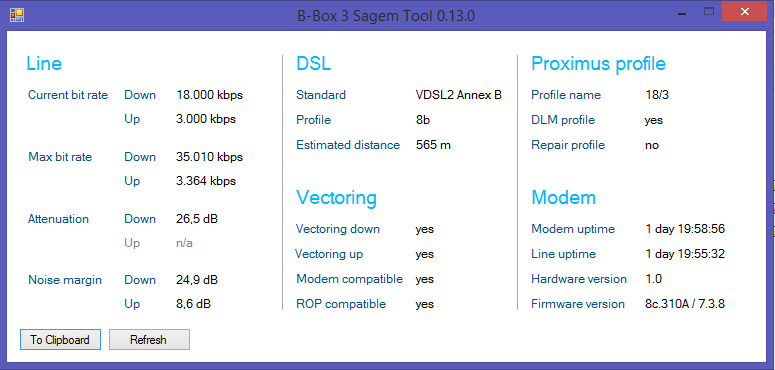

Hello everybody,
who can change my profile?
I do not know where I can complain to Proximus.
Because I actually have to have more speed.
565 meters normal must be at least 50 Mbits
Laatst gewijzigd door philippe_d 16 apr 2020, 10:52, in totaal 1 gewijzigd.
Reden: url aangepast
Berichten: 18514
Bedankt: 3777 keer
Recent bedankt: 22 keer
There is nothing to complain about :wink: .
Your profile is based on some strict rules (set by Proximus), and your line is monitored frequently to check whether an increase is possible, or a decrease is needed (DLM process) ...
Based on the distance, it looks like you are in “zone 2”
But unfortunately you are connected to a non-vectoring capable DSLAM (Ikanos) :-( .
As per table in this post:
  • - the non-vectoring base profile for your distance would be 20/6 Mbps.
    - DLM could further increase the profile up to a (theoretical) maximum of 50/10 Mbps.
    - however your line is not capable to support this maximum, hence you have been put on 30/8 Mbps.
Based on the SNR (10 dB up/down), a further increase would put you in a borderline area of instability ...
I would rather prefer a stable connection @ 30/8 above a 35/10 connection with many errors and disconnects :wink: .
Only hope for improvement is waiting until Proximus converts your line to a vectoring capable DSLAM (Broadcom)
vivanco2020
Berichten: 4
Lid geworden op: 16 apr 2020, 09:16
Englisch
Ich habe geschaut und festgestellt warum auf unsere strasse kein VDSL anschluss. Wo kann ich bescheid sagen ob auf unsere straße auch VDSL anschluss gebaut werden soll. siehe Foto
I looked and found out why there was no VDSL connection on our street. Where can I say whether VDSL connection should be built on our street. see photo
I can not understand why there is no DSLAM cabinet on our street.

Sie können nicht alles verlangen: leben im schönsten Teil Belgiens und schnelles Internet haben :-D
Sie haben also VDSL2, aber keine Vektorisierung!
Ich denke, Ihr Internet kommt direkt von der Vermittlungsstelle oder "LEX" (Zentrale) 87RAE0, Burgstrasse 4730 Raeren.
Die im LEX enthaltenen DSLAMs unterstützen leider keine Vektorisierung :-( .

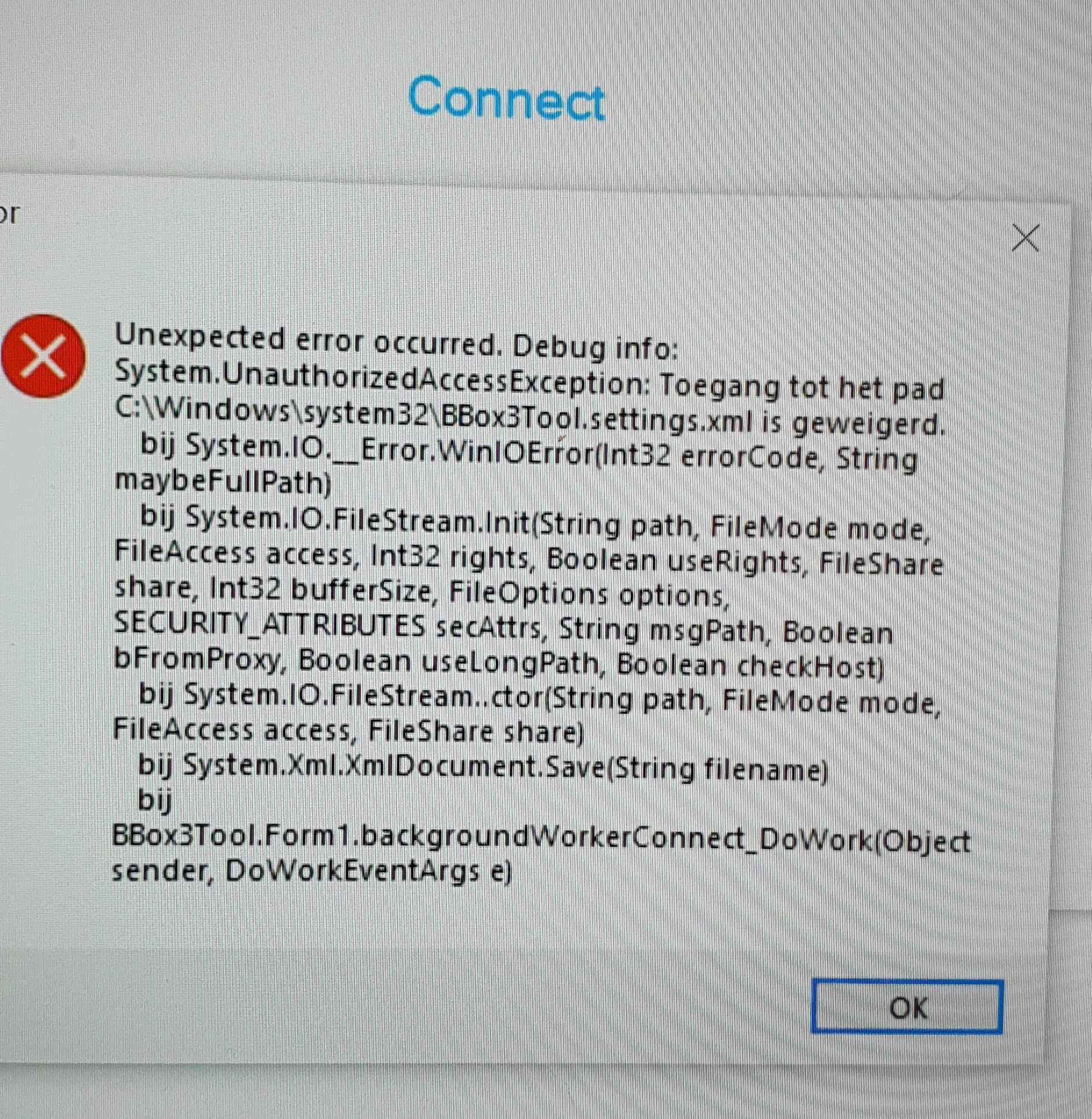

de tool werkt (zowel via laptop (draadloos) als via desktop (bedraad) maar krijg wel deze melding. IK draai op beide toestellen de laatste win 10 home
payphoneuser
Berichten: 390
Bedankt: 59 keer
Uitvoeren als Administrator, dat lost het op
Sinna
Berichten: 3297
Twitter: KrSi78
Bedankt: 234 keer
Adminrechten zijn m.i. niet nodig. Ik vermoed dat als je de tool vanuit een 'normale' folder lanceert (dus niet C:\Windows\System32) het wel zal lukken.

Kan iemand van jullie mij vertellen of er verbetering mogelijk is op mijn lijn en welke stappen ik moet ondernemen?
B-Box 3 Sagem Tool v0.13.0
Upstream current bit rate:     35 000 kbps
Downstream max bit rate:       109 138 kbps
Upstream max bit rate:         41 340 kbps
Downstream attenuation:        17,9 dB
Downstream noise margin:       19,4 dB
Upstream noise margin:         9,8 dB
Estimated distance:            450 m
Proximus profile name:         70/35
EotT
Crew support
Crew support
Berichten: 710
Bedankt: 316 keer
DLM zal jouw lijn waarschijnlijk nog wel verhogen naar 85/35. Hiervoor moet je niks doen, gewoon geduld hebben. 100/35 zal waarschijnlijk niet lukken denk ik.
hardyscript
Berichten: 552
Uitgedeelde bedankjes: 300 keer
Bedankt: 30 keer
EotT schreef:DLM zal jouw lijn waarschijnlijk nog wel verhogen naar 85/35. Hiervoor moet je niks doen, gewoon geduld hebben. 100/35 zal waarschijnlijk niet lukken denk ik.
Ik stond vroeger op 85/35 maar sinds nieuwe buren ben ik gezakt naar 70 profiel. zou een lijntest iets uithalen?
M_016
Berichten: 898
Uitgedeelde bedankjes: 9 keer
Bedankt: 106 keer
Ik vermoed dat u best even geduld oefent. Uw lijn is mogelijk teruggevallen op zijn startdebiet 70/30 omwille van een technische interventie op de distributiekabel voor de aansluiting van uw nieuwe buren en ondertussen op een DLM-profiel 70/35 gebracht op basis van resultaten van automatisch lopende tests.
Vermits de noise margin down >> 10 dB is de kans op terug 85/35 mijns inziens inderdaad zeker reëel

Volgens mij is die start debiet niet 70 maar 50 als men in zone 2 zit (zijn afstand meting is 450m) , maar de lijn zou in principe wel moeten 85 Mbps aankunnen.
