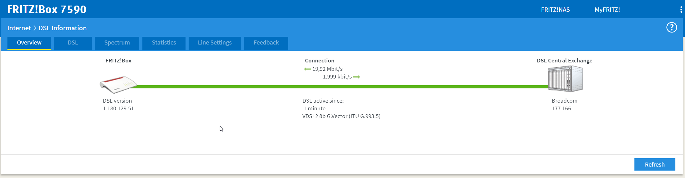

lynx9274
- Berichten: 38
- Lid geworden op: 17 nov 2018, 11:20
Hey Friends,
I am not sure if the 7590 is finally whitelisted but I connected the international version now. I Updated to the new OS with DSL Version
1.180.129.51 and keeping my fingers crossed that the line will not switch to repair profile as it did in the past when I tried the German version.
What I noticed is that the Download speed is pretty much the same compared to the bbox3 (20 Mbit/s) however with the Bbox3 I was able to get 3 Mbit/s Upload while the FB is only doing 2 Mbit/s. Since Upload is hugely important and very slow to beginn with I don't know if it is an upgrade to use the FB instead of the BBOX3. Is there anything I can do to improve the speed somehow?
Best,
Thomas
Best,
Thomas
lynx9274
- Berichten: 38
Unfortunately it went back on Repair profile. I had to plug in the bbox3 again for it to jump back to the normal VDSL profile.
Reading from the Sagem tool says the distance to the box is 1068m. this must be very high so no hope to get a faster connection I assume?
What about switching to telenet on a coax connection? would that give me a better speed.
What would you guys do in my situation?
