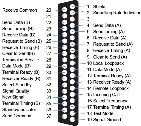

Printerpoort is DB25. DB37 komt voor in de V11 standaard.
uit wikipedia:
uit wikipedia:
Seriele communicatie dus, maar met symmetrische signalen.V.11 is an ITU-T recommendation, first agreed in 1976, for balanced electrical circuits for data communication at up to 10 Mbit/s. Used with the 37-pin ISO 4902 connector, it is compatible with EIA-422. The 15-pin ISO 4903 connector is recommended for data network interface.
