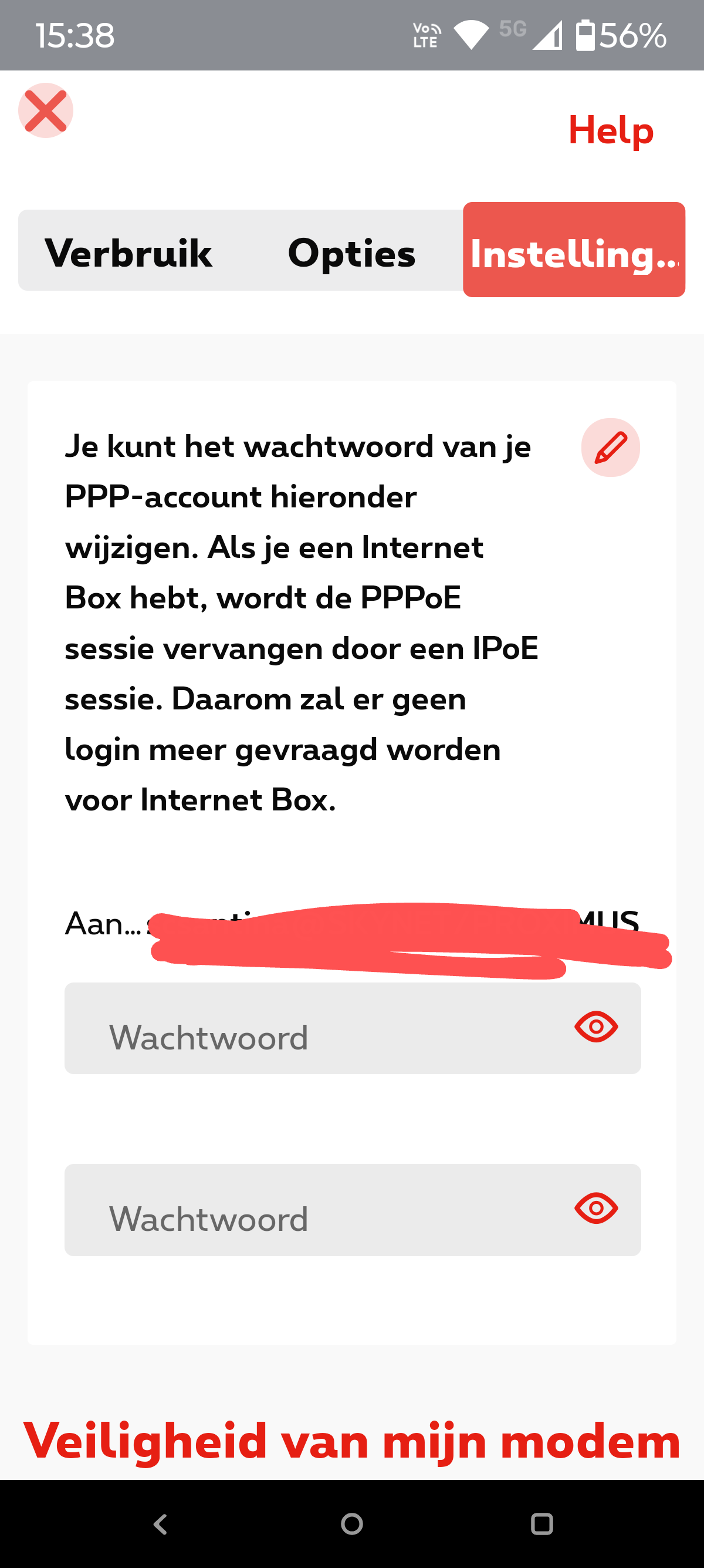

I was interested in this as well - new proximus customer - got a BBOX 3 - V ( We have big stocks ).
I see the option to migrate to single vlan - but it fails ...
I can upgrade to the internet box for 49 euro ... that's a new proximus strategy
- Berichten: 2817
- Bedankt: 247 keer
For reference and info.
Tried to change multiple times to single vlan and it failed.
Then I disconnected the modem and I changed to single vlan, that worked. I switched out my bbox v3 for a A-Mod 3, I did activate DHCP vlan 20 and it works now, ipoe. And less power consumption with the amod in stead of the BBOX v3.
