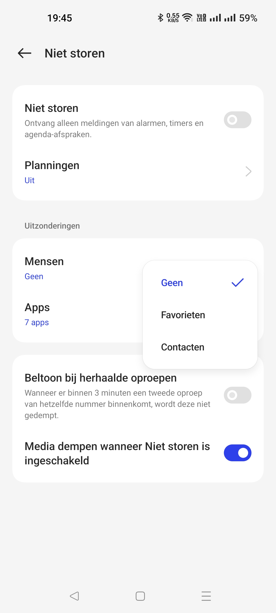

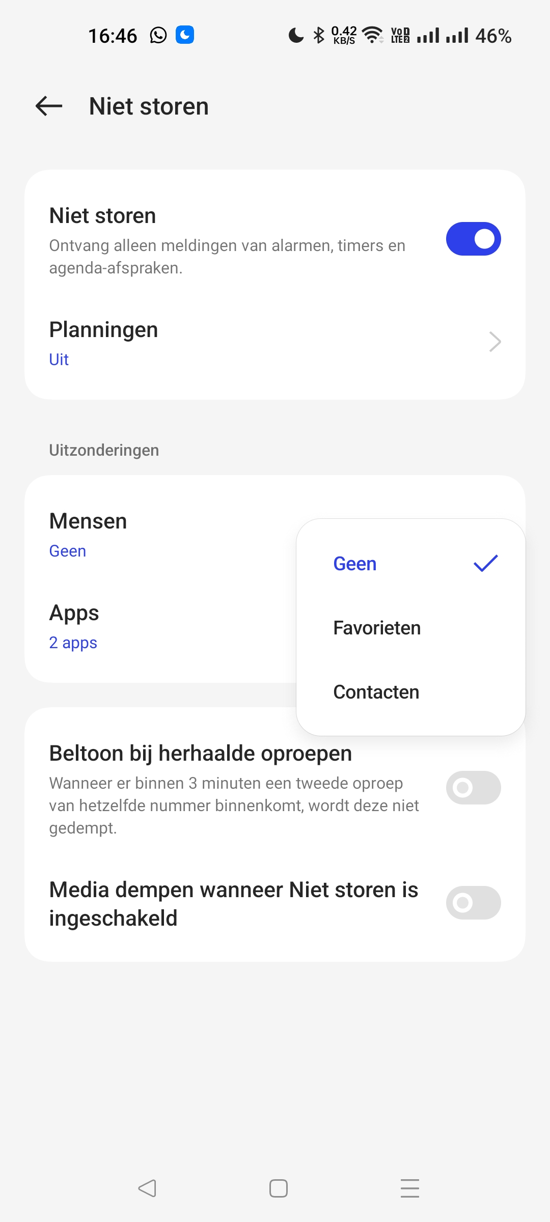

Hoe kun je Android 13 instellen om enkel gebeld te worden (eventueel in de niet storen modus) ?
In Android 11 had je de optie om enkel telefoons toe te laten in niet storen, nu is dit enkel favorieten en contacten.
Toestel: Oneplus 9

honda4life schreef: 04 dec 2022, 16:05 Blijft toch zo bij Android 13 dat je enkel bellen toe kan laten?
Enkel deze optie: zie bijlage

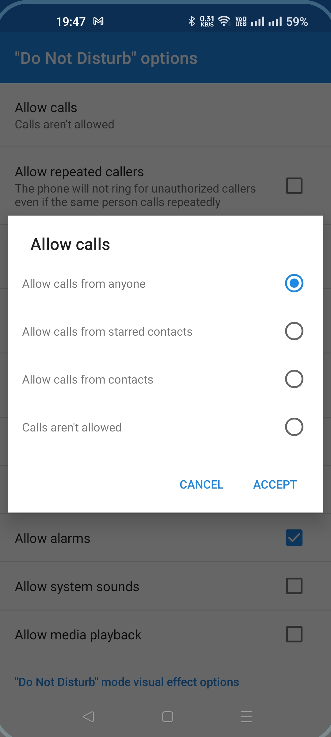

honda4life schreef: 04 dec 2022, 22:04 Heel vreemd... Al eens Google geprobeerd naar lotgenoten met hetzelfde toestel?
Bij Android 12 (Oneplus Nord) is de optie er wel.

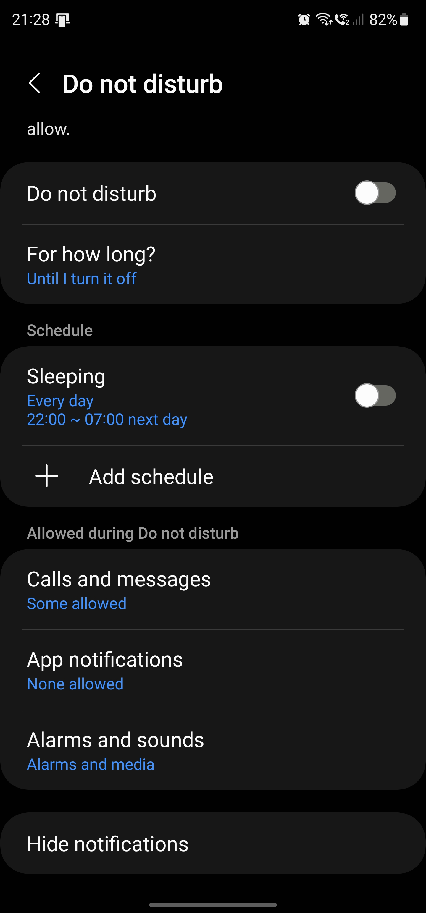

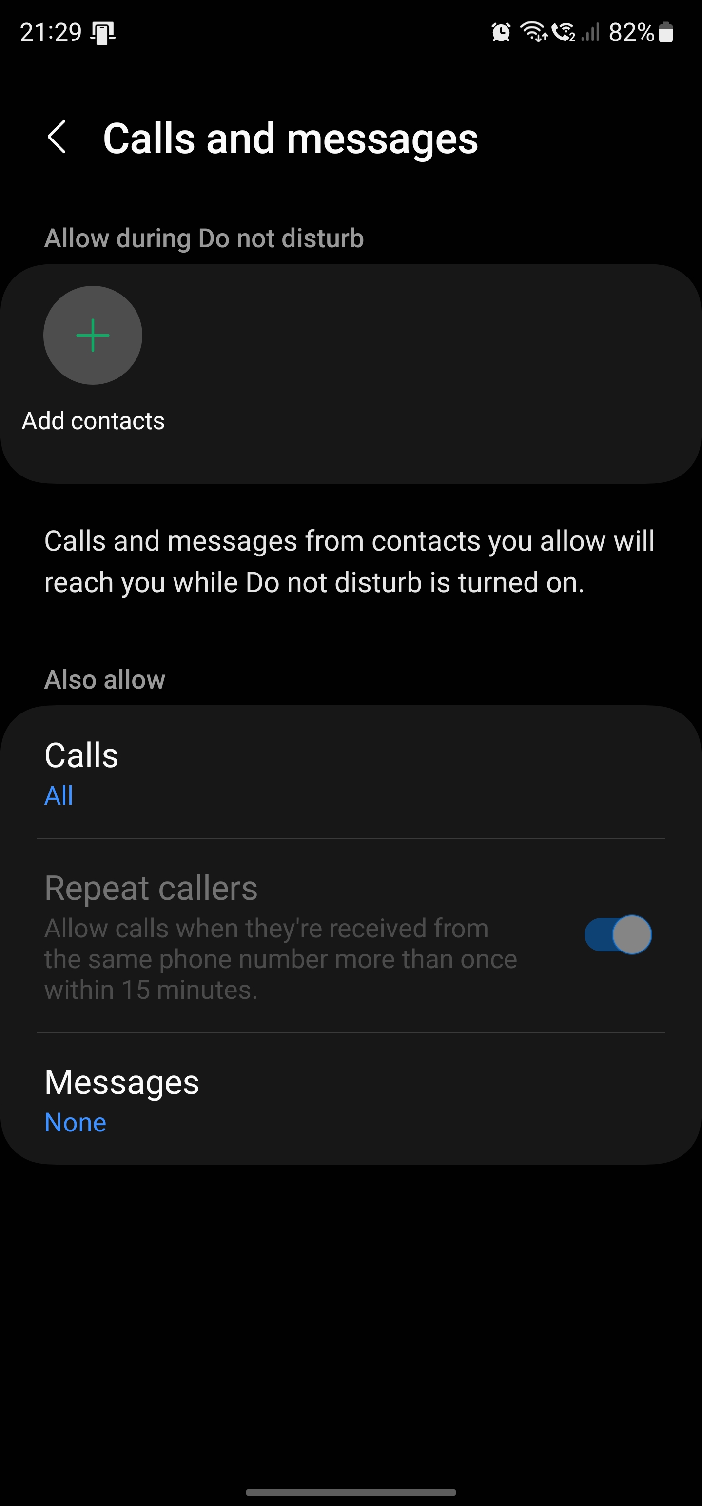

Android 13 One UI 5.1 S23 Ultra

Bedankt: 103 keer
Antwoord gehad van Oneplus support:
Thank you for contacting OnePlus Customer Support and for your interest in our products.
This particular feature was discontinued with the OS 13 update as very few people were making use of it. Your response is invaluable to us, and we wanted to let you know how important your thoughts are to the team at OnePlus. We will make sure to forward your feedback to the development team.
We also recommend you post your feedback on the official OnePlus community forum here: https://community.oneplus.com/.
Have a wonderful day and we thank you for your patience and understanding
