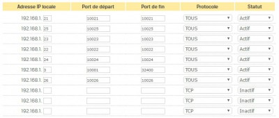

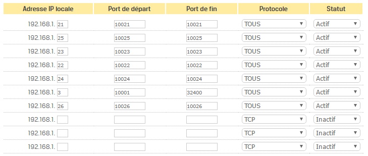

benoitmabille
Berichten: 4
Lid geworden op: 05 jan 2017, 18:48
Hello,
PORT FORWARDING
I am using non-blocked ports (100xx range). My devices are on static IP of course.
6 ports are forwarded, the test is simple :
1) Disable all forwards.
2) enable the first forward, test OK
3) enable the second forward, test OK
6) enable the fifth forward, test OK
7) enable the sixth forward, test NOK :eek:
Have tried numerous time, with different ports, with more than 5 forwards, some are ignored :bang:
The telenet router can do 10 forwards (limited by its interface presumably)
DHCP
I am using Telenet for 15 years and, yes, the DHCP used to be configurable. When that option disappeared a few years ago, I asked Telenet to switch it off for me, I use my own DHCP.
UPDATE
Two days ago, for the first time I had a knowledgeable person named IAN (he is studying for CISCO certification) at Telenet support, he understood quickly everything, we performed some tests and trials together, he liaised with his technical team and a technical report has been made. I am promised an answer within 3 days.
An alternative is to get a Telenet modem-only (yes it is possible) and I will provide my own firewall/router :lol:
The WiFi on my DOCSIS is erratic, devices dont connect etc.. My 3 other AP work well with the same devices :evil:
I believe that my DOCSIS has an issue (firmware ?) :wink:
Thanks all
Benoit

Kenniey
Berichten: 496
Bedankt: 59 keer
Can you provide a screenshot of your portforwardingscreen in "mijn telenet"?
I think something is wrong there.

Right now, only one forward works :eek: unpredictable :?
After the router there is a Netgear GS116E switch, DHCP is performed by the NAS.
Thanks ! :-D
Port forward settings
Benoit

benoitmabille schreef:Right now, only one forward works :eek: unpredictable :?
You have overlapping ports:
device 192.168.1.3 from 10001 to 32400 ??

Kenniey
Berichten: 496
Bedankt: 59 keer
The ports in Mijn telenet are start en end. Not internal and external port.
