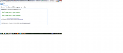

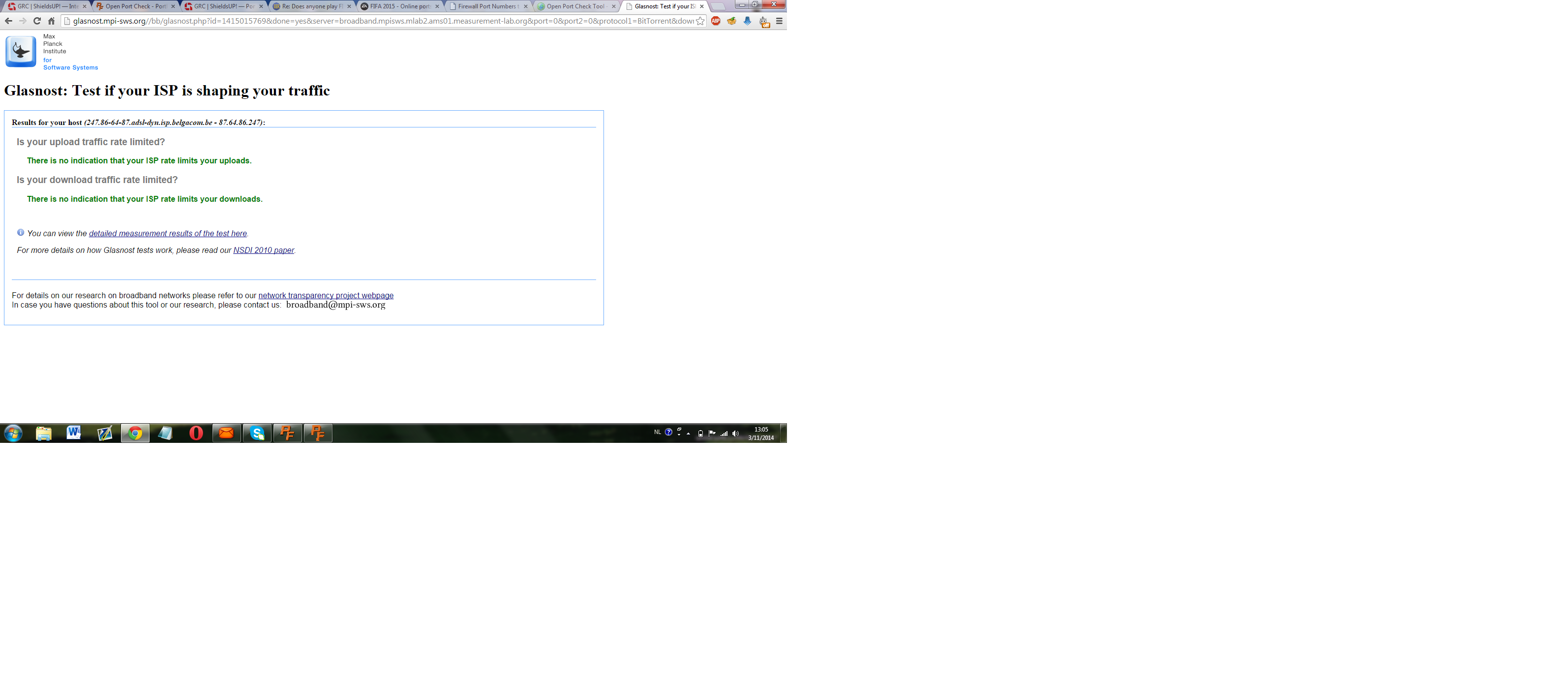

langf
Berichten: 10
Lid geworden op: 02 nov 2014, 22:32
Dit zijn mijn resultaten.

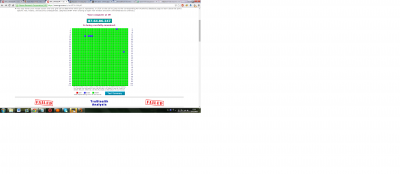

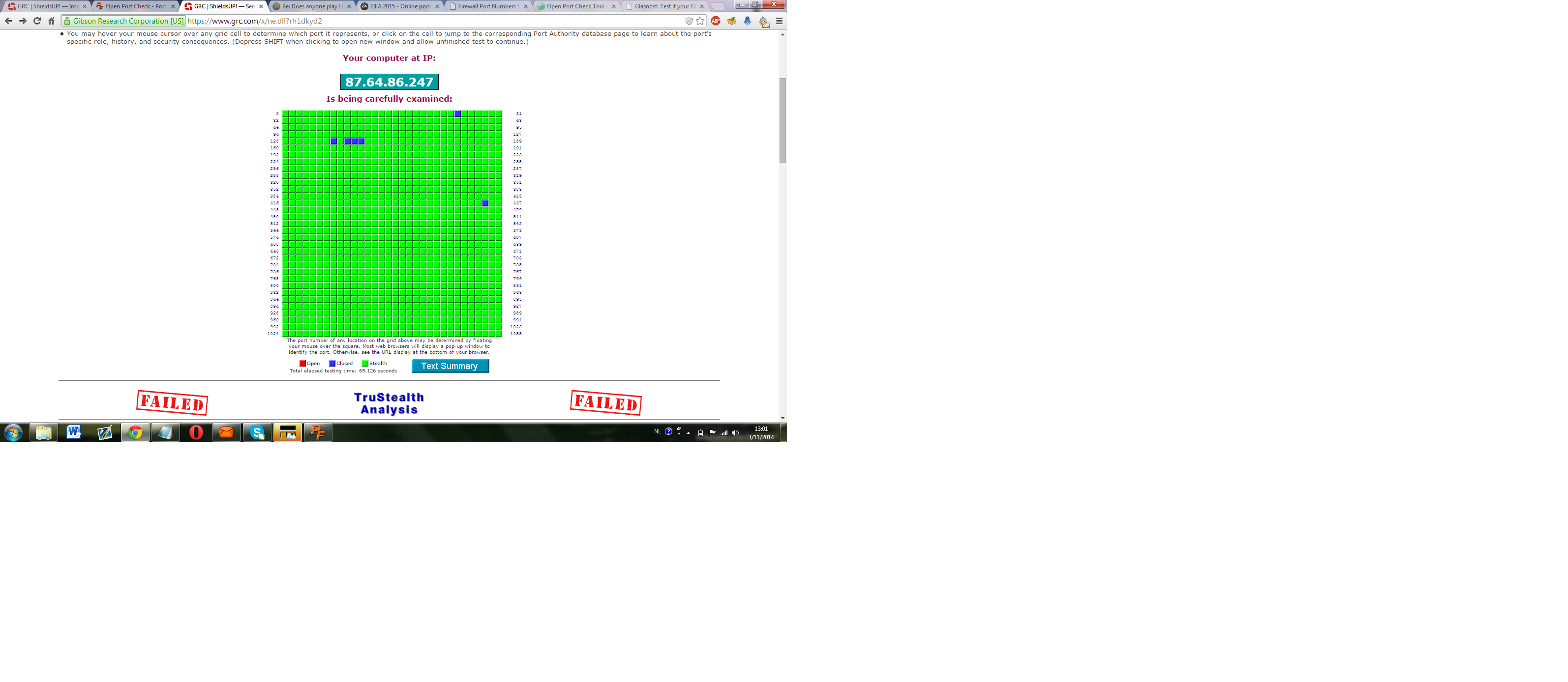

langf
Berichten: 10
GRC Port Authority Report created on UTC: 2014-11-03 at 12:04:48
Results from scan of ports: 0-1055
0 Ports Open
6 Ports Closed
1050 Ports Stealth
1056 Ports Tested
NO PORTS were found to be OPEN.
Ports found to be CLOSED were: 25, 135, 137, 138, 139, 445
Other than what is listed above, all ports are STEALTH.
TruStealth: FAILED - NOT all tested ports were STEALTH,
- NO unsolicited packets were received,
- NO Ping reply (ICMP Echo) was received.
