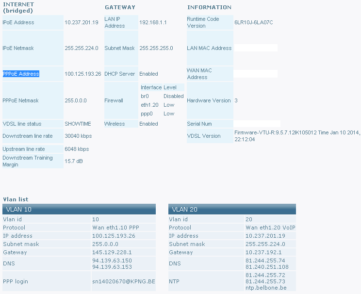

hellow
i use snowbase service, but my problem is i can't access my localhost,
if i login in my router, dynamic dns
the public ip adress is not the same non bogan IP Adress in my router,
its like am NATTED behind the ISP's NAT Router.
is this the case or not?
if am not NATTEd behind the ISP,s NAT Router how should i do?
do you have any idea?
Sagemcom fast 3464 access to localhost through public ip

I think that op's question is if SNOW (Base) applies carrier-grade NAT because he/she sees a different IP on the router and in a test like here: http://ip.userbase.be . Because of this setting up a dyndsn-service fails.

I doubt SNOW (KPN) applies CGNAT for the residential connections. I'm a SNOW-user and currently have a 145.129.86.x address.
I don't know if all ports are open for a SNOW-connection, but I don't think so.

#4. als ik inloggen in DynDNS detecteren de PPPoE-adres 100.125.193.26, als ik voor publiek-IP adres zijn falenSinna schreef:I doubt SNOW (KPN) applies CGNAT for the residential connections. I'm a SNOW-user and currently have a 145.129.86.x address.

100.125.193.26 is part of the mentioned range, so it seems Snow does apply CGN.IETF created RFC 6598, detailing Shared Address Space for use in ISP CGN deployments and NAT devices that can handle the same addresses occurring both on inbound and outbound interfaces. ARIN returned space to the IANA as needed for this allocation. The allocated address block is 100.64.0.0/10.
I noticed the same problem yesterday. My modem has a 100.125.x.y address, the public ip is 145.129.a.b.
I am sure I still had a public ip a few days ago, because I accessed my home PC from outside the home network. Since the OP already reported this a month ago, it seems SNOW is rolling this out gradually or they are using a mix of public and CGN ips.
