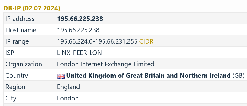

Ik zag dit op mijn Proximus fiber lijn:

Wat zeiden ze?
Vanop een PXS VDSL-aansluiting:
Tracing route to dns9.quad9.net [9.9.9.9]
over a maximum of 30 hops:
  1     4 ms     3 ms     3 ms  mymodem.lan [192.168.1.1]
  2    12 ms    11 ms    12 ms  10.24.1.43
  3     *        *        *     Request timed out.
  4    14 ms    13 ms    13 ms  ae-60-100.ibrstr5.isp.proximus.be [91.183.241.168]
  5     *        *        *     Request timed out.
  6     *        *        *     Request timed out.
  7     *        *        *     Request timed out.
  8    21 ms    22 ms    47 ms  195.66.225.238
  9    19 ms    20 ms    27 ms  dns9.quad9.net [9.9.9.9]
Ik kom uit op Quad9's server in de Londen Internet exchange.
Screenshot 2024-07-31 at 22-19-13 IP and website location Check host - online website monitoring.png
