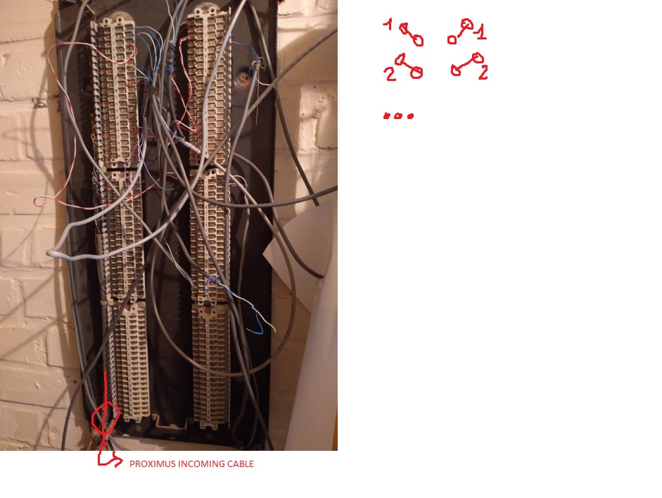

Just a quick update. I contacted our landlord (we live in a small 6-unit multi-tenant apartment) and turns out another tenant has the same issue. The main security door to the building was replaced/installed recently and the technicians were messing with the intercom/buzzer ('parlaphone'). The intercom does not work anymore, so that is a sign that they did screw up some wiring. So before calling the Proximus technician, we are waiting on the diagnosis from the landlord.
I checked the main telephone wiring cabinet myself (it is in the common basement) and suffice to say it is a complete mess (no labeling, lots of loose cables, not in any enclosed cabinet).

@sociableorg
Left big cable is proximus ,
Just check those blue and white like i marked on picture
Pair 1
O ----- O White 1 (person 1)
O - O Blue 1
O ----- O White 2 (person 2
O - O Blue 2
Maybe there is a bad connection there somewhere.
Try find your cable, and check connections :)
Easy to find your cable, disconnect 1 wire in that big box, and see if you have signal on modem. If not you found your cable, if yes ,mount wire back and try another one.
also look at those wires it's clear copper, some use to have a little clear isolation .
Once you find your cable. You can mark him
If someone switched, only proximus will be the one who can fix this.
Only they know wich line comes out of witch wires . Since you talk of the intercom not working also.
example,
pair 1 = VDSL signal
pair 2 = VDSL signal
pair 3 = intercom PHONE
pair 4 = VDSL signal
Normally vdsl and telephone line have different voltages. If you have a tool, measure them out.

Thanks a lot for your help! I did troubleshoot the cable and looks like the wiring in the cabinet downstairs seems OK. The technician was here today and he first replaced the modem without checking anything :think: :think: :nono:. I tried to ask him what he was doing, but looks like they have a fixed set of steps they follow. No surprise that even after replacing the modem, my line was still under 'repair' profile. I then tried to explain to him the output of the sagem tool, but he said they had their own tools (fair enough) but it took him another 10 mins to come to the same conclusion. He said there was some big problem on the line between the splitter and the CO (I assume, because he said he had to get another team to intervene). Now the problem is a bit in limbo - not sure who is actually working on the issue but the technician promised that he had called in for more help.
Net-net: I have a new modem, but have the same problem as before :? :? I have improvement in the speed (a bit more, but not near the profile I had before).
