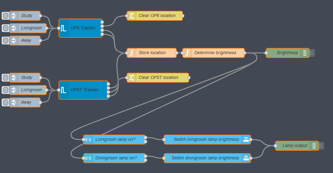

Ik heb in home assistant al presence detection via tado en wifi (unifi controller)
Dat werkt perfect. HA geeft per gebruiker mooi weer of die thuis is of niet.
Maar ik zou willen weten op welke AP deze geconnecteerd is. Op internet vind ik niet dadelijk antwoorden.

Ik heb zoiets gebouwd, en dat werkt... maar het is niet echt vriendelijk als je met veel mensen zit die je wilt tracken.
Ik baseer me op de new_state.attributes.ap_mac, en dus het MAC adres van het AP.
[{"id":"3eb38d5e.e59912","type":"inject","z":"a14cb62d.365d4","name":"Study","topic":"","payload":"{\"entity_id\":\"device_tracker.oneplus6\",\"old_state\":{\"state\":\"home\",\"attributes\":{\"ap_mac\":\"xx:xx:xx:xx:xx:xx\"}},\"new_state\":{\"state\":\"home\",\"attributes\":{\"ap_mac\":\"xx:xx:xx:xx:xx:xx\"}}}","payloadType":"json","repeat":"","crontab":"","once":false,"onceDelay":0.1,"x":90,"y":60,"wires":[["3add9afa.c1b24e"]]},{"id":"3add9afa.c1b24e","type":"trigger-state","z":"a14cb62d.365d4","name":"OP6 Tracker","server":"5f01146c.501bec","entityid":"device_tracker.oneplus6","entityidfiltertype":"exact","debugenabled":false,"constraints":[{"id":"m4yph6mr2nm","targetType":"this_entity","targetValue":"","propertyType":"current_state","propertyValue":"new_state.state","comparatorType":"is","comparatorValueDatatype":"str","comparatorValue":"home"}],"constraintsmustmatch":"all","outputs":4,"customoutputs":[{"outputId":"sikaxqno59","messageType":"payload","messageValue":"livingroom","messageValueType":"json","comparatorPropertyType":"property","comparatorPropertyValue":"new_state.attributes.ap_mac","comparatorType":"is","comparatorValue":"yy:yy:yy:yy:yy:yy"},{"outputId":"ty0ja2o5qb","messageType":"payload","messageValue":"study","messageValueType":"json","comparatorPropertyType":"property","comparatorPropertyValue":"new_state.attributes.ap_mac","comparatorType":"is","comparatorValue":"xx:xx:xx:xx:xx:xx"}],"outputinitially":false,"state_type":"str","x":270,"y":100,"wires":[[],["3ad64e68.958912"],["438ebcf5.f387ec"],["438ebcf5.f387ec"]]},{"id":"bd7a4d76.aa72c8","type":"api-current-state","z":"a14cb62d.365d4","name":"Livingroom lamp on?","server":"5f01146c.501bec","version":1,"outputs":2,"halt_if":"on","halt_if_type":"str","halt_if_compare":"is","override_topic":false,"entity_id":"light.ikea_lights_livingroom","state_type":"str","state_location":"","override_payload":"none","entity_location":"","override_data":"none","blockInputOverrides":false,"x":380,"y":460,"wires":[["3af0f039.7ebe48"],[]]},{"id":"ff433ddb.8215a","type":"api-current-state","z":"a14cb62d.365d4","name":"Diningroom lamp on?","server":"5f01146c.501bec","version":1,"outputs":2,"halt_if":"on","halt_if_type":"str","halt_if_compare":"is","override_topic":false,"entity_id":"light.ikea_lights_diningroom","state_type":"str","state_location":"","override_payload":"none","entity_location":"","override_data":"none","blockInputOverrides":false,"x":380,"y":520,"wires":[["6a3e012c.f55e5"],[]]},{"id":"6a3e012c.f55e5","type":"api-call-service","z":"a14cb62d.365d4","name":"Switch diningroom lamp brightness","server":"5f01146c.501bec","version":1,"debugenabled":false,"service_domain":"light","service":"turn_on","entityId":"light.ikea_lights_diningroom","data":"{    \"brightness\": {{payload}},    \"transition\": 5}","dataType":"json","mergecontext":"","output_location":"payload","output_location_type":"msg","mustacheAltTags":false,"x":680,"y":520,"wires":[["7117463a.2adef8"]]},{"id":"3af0f039.7ebe48","type":"api-call-service","z":"a14cb62d.365d4","name":"Switch livingroom lamp brightness","server":"5f01146c.501bec","version":1,"debugenabled":false,"service_domain":"light","service":"turn_on","entityId":"light.ikea_lights_livingroom","data":"{    \"brightness\": {{payload}},    \"transition\": 5}","dataType":"json","mergecontext":"","output_location":"payload","output_location_type":"msg","mustacheAltTags":false,"x":680,"y":460,"wires":[["7117463a.2adef8"]]},{"id":"7117463a.2adef8","type":"debug","z":"a14cb62d.365d4","name":"Lamp output","active":false,"tosidebar":true,"console":false,"tostatus":false,"complete":"payload","targetType":"msg","x":970,"y":480,"wires":[]},{"id":"1ec5cb28.c96d1d","type":"inject","z":"a14cb62d.365d4","name":"Livingroom","topic":"","payload":"{\"entity_id\":\"device_tracker.oneplus6\",\"old_state\":{\"state\":\"home\",\"attributes\":{\"ap_mac\":\"yy:yy:yy:yy:yy:yy\"}},\"new_state\":{\"state\":\"home\",\"attributes\":{\"ap_mac\":\"yy:yy:yy:yy:yy:yy\"}}}","payloadType":"json","repeat":"","crontab":"","once":false,"onceDelay":0.1,"x":100,"y":100,"wires":[["3add9afa.c1b24e"]]},{"id":"d6e0a2a9.82b67","type":"inject","z":"a14cb62d.365d4","name":"Study","topic":"","payload":"{\"entity_id\":\"device_tracker.oneplus_5t\",\"old_state\":{\"state\":\"home\",\"attributes\":{\"ap_mac\":\"xx:xx:xx:xx:xx:xx\"}},\"new_state\":{\"state\":\"home\",\"attributes\":{\"ap_mac\":\"xx:xx:xx:xx:xx:xx\"}}}","payloadType":"json","repeat":"","crontab":"","once":false,"onceDelay":0.1,"x":90,"y":260,"wires":[["9fa5639b.a10048"]]},{"id":"5f776fc4.beaf9","type":"inject","z":"a14cb62d.365d4","name":"Livingroom","topic":"","payload":"{\"entity_id\":\"device_tracker.oneplus_5t\",\"old_state\":{\"state\":\"home\",\"attributes\":{\"ap_mac\":\"yy:yy:yy:yy:yy:yy\"}},\"new_state\":{\"state\":\"home\",\"attributes\":{\"ap_mac\":\"yy:yy:yy:yy:yy:yy\"}}}","payloadType":"json","repeat":"","crontab":"","once":false,"onceDelay":0.1,"x":100,"y":300,"wires":[["9fa5639b.a10048"]]},{"id":"438ebcf5.f387ec","type":"function","z":"a14cb62d.365d4","name":"Store location","func":"if (msg.topic == \"device_tracker.oneplus_5t\") {\n    flow.set(\"op5t\", msg.payload);\n} else if (msg.topic == \"device_tracker.oneplus6\") {\n    flow.set(\"op6\", msg.payload);\n}\n\nreturn msg;","outputs":1,"noerr":0,"x":500,"y":180,"wires":[["cc7cf062.72b158"]]},{"id":"cc7cf062.72b158","type":"function","z":"a14cb62d.365d4","name":"Determine brightness","func":"var brightness = 1;\nvar max_brightness = 216;\n\nvar dev1 = flow.get('op5t') || '';\nvar dev2 = flow.get('op6') || '';\n\nif (dev1 == \"livingroom\" || dev2 == \"livingroom\") {\n    brightness = max_brightness;\n}\n\nvar newmsg = { payload: brightness };     \nreturn newmsg;","outputs":1,"noerr":0,"x":700,"y":180,"wires":[["bd7a4d76.aa72c8","ff433ddb.8215a","5ffe467b.bc1e1"]]},{"id":"3ad64e68.958912","type":"change","z":"a14cb62d.365d4","name":"Clear OP6 location","rules":[{"t":"delete","p":"op6","pt":"flow"}],"action":"","property":"","from":"","to":"","reg":false,"x":510,"y":60,"wires":[[]]},{"id":"74ade5db.400c5c","type":"change","z":"a14cb62d.365d4","name":"Clear OP5T location","rules":[{"t":"delete","p":"op5t","pt":"flow"}],"action":"","property":"","from":"","to":"","reg":false,"x":520,"y":260,"wires":[[]]},{"id":"7451b8f8.a5fe78","type":"inject","z":"a14cb62d.365d4","name":"Away","topic":"","payload":"{\"entity_id\":\"device_tracker.oneplus6\",\"old_state\":{\"state\":\"away\",\"attributes\":{\"ap_mac\":\"yy:yy:yy:yy:yy:yy\"}},\"new_state\":{\"state\":\"away\",\"attributes\":{\"ap_mac\":\"yy:yy:yy:yy:yy:yy\"}}}","payloadType":"json","repeat":"","crontab":"","once":false,"onceDelay":0.1,"x":90,"y":140,"wires":[["3add9afa.c1b24e"]]},{"id":"5ea4c433.72dcec","type":"inject","z":"a14cb62d.365d4","name":"Away","topic":"","payload":"{\"entity_id\":\"device_tracker.oneplus_5t\",\"old_state\":{\"state\":\"away\",\"attributes\":{\"ap_mac\":\"yy:yy:yy:yy:yy:yy\"}},\"new_state\":{\"state\":\"away\",\"attributes\":{\"ap_mac\":\"yy:yy:yy:yy:yy:yy\"}}}","payloadType":"json","repeat":"","crontab":"","once":false,"onceDelay":0.1,"x":90,"y":340,"wires":[["9fa5639b.a10048"]]},{"id":"9fa5639b.a10048","type":"trigger-state","z":"a14cb62d.365d4","name":"OP5T Tracker","server":"5f01146c.501bec","entityid":"device_tracker.oneplus_5t","entityidfiltertype":"exact","debugenabled":false,"constraints":[{"id":"m4yph6mr2nm","targetType":"this_entity","targetValue":"","propertyType":"current_state","propertyValue":"new_state.state","comparatorType":"is","comparatorValueDatatype":"str","comparatorValue":"home"}],"constraintsmustmatch":"all","outputs":4,"customoutputs":[{"outputId":"sikaxqno59","messageType":"payload","messageValue":"livingroom","messageValueType":"json","comparatorPropertyType":"property","comparatorPropertyValue":"new_state.attributes.ap_mac","comparatorType":"is","comparatorValue":"yy:yy:yy:yy:yy:yy"},{"outputId":"ty0ja2o5qb","messageType":"payload","messageValue":"study","messageValueType":"json","comparatorPropertyType":"property","comparatorPropertyValue":"new_state.attributes.ap_mac","comparatorType":"is","comparatorValue":"xx:xx:xx:xx:xx:xx"}],"outputinitially":false,"state_type":"str","x":280,"y":300,"wires":[[],["74ade5db.400c5c"],["438ebcf5.f387ec"],["438ebcf5.f387ec"]]},{"id":"5ffe467b.bc1e1","type":"debug","z":"a14cb62d.365d4","name":"Brightness","active":false,"tosidebar":true,"console":false,"tostatus":false,"complete":"payload","targetType":"msg","x":940,"y":180,"wires":[]},{"id":"5f01146c.501bec","type":"server","z":"","name":"Home Assistant"}]

devilkin schreef:Ik heb zoiets gebouwd, en dat werkt... maar het is niet echt vriendelijk als je met veel mensen zit die je wilt tracken.
Thx. dat werkt idd zoals het hoort.
[/quote]
Wat doet diet blocked en allowed uitgang van die trigger?
Op de debugger zie ik daar niets verschijnen.
