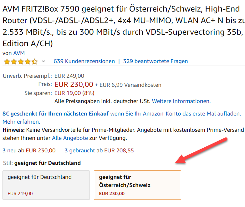

Dear Friends,
unfortunately my dutch is not good and I've been trying to look for a solution in this thread. Maybe you can help me with my situation.
I live in Belgium close to the german border and internet has been a struggle here.
For the past 4 years the best I could get here was a proximus subscription with ADSL a download Speed of D: 7Mbit/s U: 0.5 Mbit/s which made it very hard to enjoy and kind of online experience.
Recently the technician came by and I was able to press him hard to switch my line to vectoring. Which this switch there was (for my standards) a huge improvement of the line to D: 17 Mbit/s U: 1.7 Mbit/s. I am connected using the BBOX3, the device is about 2 Years old and I decided to give the Fritzbox a try in the hope to somehow improve the connection, even if only by a small margin.
I plugged in the FB 7590 and updated it to the latest Version (7.01). Initially I was surprised that it worked right away on VLAN Port 10. After 2 Hours the vectoring profile was switched to the fallback profile @ D7.5 M/bits U: 0.5 Mbit/s :(
As far as i understand not all firmwares are whitelisted and this firmware and box is too new to function with proximus at the moment and there is very little that can be done to use the FB 7590 with proximus right? I would really prefer using over the Bbox because the quality of wireless reception and the seamless function with repeaters. It also gives me more insight into the connection that is currently established.
I am also hoping that somehow the maximum attainable speed that is displayed in the stats when on the higher profile can be reached using the fritzbox.
Attached you find the details when the FB was on the better profile and also the details when it switched to the fallback profile.
Is it possible to stabilize the FB on the highest profile and continue using it or do I have to use the BBOX as a bridge and connect the FB to the BBOX to use it? Also how about connecting the WAN port of the FB with the LAN port of the BOX and disabling the PPP connection on the BBOX and connecting PPP with the FB.
What about the line test that can be done calling proximus to determine the new profile. Does that grant me a chance to increase the overall profile and achieve higher speeds on the FB as opposed to what the BBOX can deliver?
What would you do in my situation? Return the FB and keep using BBOX because it is more stable? For me every little drop of bandwidth matters (especially in the upload) and i am very desperate to achieve some kind of improvement. When I plug my bbox back in it reverts to the 20M profile after a few hours. The proximus technician told me that the BBOX has a unique capability to filter noise and optimize the vectoring on the proximus network... would you still keep your FB when the BBOX is needed to supply the DSL signal or would you just return the FB?

Hi
I believe you have a number of issues:
  1. the FritzBox 7590 is not (yet) whitelisted for use on the Belgian telecom network. However the good news is that AVM/EDPnet are intending to get the 7590/7390 whitelisted, but this is a (too) slow process, hence some patience is needed :(.
  2. the FritzBox 7590 you are using seems to be the German version? This will never be approved in Belgium. You will need the international version, configured to country = Belgium. Note that the international version also has a German language interface.
The options you have are:
  • Wait until the 7590 is whitelisted (but switch to the international or A/CH version).
  • Swap the 7590 with a 7490 (international). This one is whitelisted (OS 7.01).
  • Use a 2-box configuration: set-up the Proximus B-box as a modem, and connect the B-box to the WAN port of your 7590.
Anyway, you will need some action to get rid of the fall-back profile, wich will not dissappear automatically :-( .
This is called the "TBF" (test de bonne fin), and is performed by calling 0800 22424, followed by the line number (which you can find om your Proximus invoice (e.g. 087 xxxxxx).
Any more questions, please shout :)

Thanks again for your input.
So is this verison the international version? It says Australia/Switzerland.
I purchased the German version.
I can return the german version and buy the A/S version?
Also when I buy the A/S Version can I then Flash the belgian version or how does this work?

lynx9274 schreef:So is this verison the international version? It says Australia/Switzerland.
The A/CH version is exactly the same hardware and Firmware as the international version (apart from the phone adapters, e.g. TAE ..).
The international version has Art. Nr 2000 2804
230€ + 6.99€ Versand? You may find cheaper :wink:
Kommago.nl: 204.50€ (Dutsch website, free delivery in Benelux)
