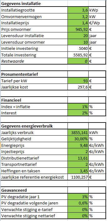

In the last months there has been some turmoil about the effects of the new digital meter on the profitability of existing photovoltaic (PV) installations. In this article we take a deeper look at the situation.
In hun studie gaan ze daar ook uit van een TVT met het huidige systeem (het net doet dienst als batterij + prosumententax) van 7 jaar.A net metering regime has the issue that owners of PV installations stop contributing to the grid financially while still using it intensely. To solve this issue a yearly fee, its size determined by the maximum power of the PV inverter, was levied on owners of PV installations. This is what came to be known as the ‘prosumer tax’. This fee corresponds approximately to 73% of the grid tariffs the installation owner would pay if he or she didn’t have a PV system
Wat complete onzin is: prosumententax zou me €400 per jaar kosten, op een huidige elektriciteitsrekening van €700-800, dus een investering van €6500 verdien ik dan terug op 15 jaar.
Een manier om de TVT te reduceren, is een beperking van het vermogen de inverter.
Ik vind de studie maar slappe kost en open deuren in trappen, maar toch.(...) the VREG, the Flemish energy regulator, who sees the ‘cheating’ on the prosumer tax by undersized PV inverters as a growing problem. By significantly undersizing the maximum power of a PV inverter in relation to the power of the connected solar panels, the owner of the system pays significantly less prosumer tax while only losing a little yearly energy yield. This is caused by the fact that at latitudes such as in Flanders and further north, the maximum power of the solar panels is only reached a small amount of hours per year. Only for a few hours or days in spring and summer will the smaller PV inverter limit the power output of the solar panel array.
- de TVT klopt niet
- er worden geen suggesties gedaan die zowel de ZP-bezitter als de rest van de maatschappij tevreden kan houden
De enige manier die ik zie is de invoering van de slimme meter laten samengaan met slimme verbruikers en een slimme batterij.
Het doel moet dan zijn om de injectie op het net te verlagen en zelf zo veel mogelijk te consumeren van de opgewekte elektriciteit: hetzij rechtstreeks door toestellen (wasmachine, vaatwasser, ...) , hetzij onrechtstreeks via een batterij.
Wel grappig dat ze het realistisch afstemmen van je omvormer capaciteit op basis van je reeele productie "cheaten" noemen
Ze zouden beter de belasting op iets wat je niet produceerd pure diefstal noemen !
Trouwens wat je TVT van 15 jaar betreft... je vergeet nog mogelijke defecte zoals een nieuwe omvormer (de meeste geven het op na een goeie 10 jaar) en eventueel problemen met panelen.

Ik heb de cijfers gekregen van de berekening van de TVT uit de studie en op het eerste zicht kloppen deze. Ze hebben wel heel goedkope panelen en en omvormers in rekening gebracht en een lage prosumertax maar wat wij vergeten zijn is dat we bij de berekening van de TVT geen geld meer moeten uitgeven aan de electriciteit die we anders zouden moeten kopen.
En ja, hun omvormer is ook lager gedimensioneerd om minder prosumertax te moeten betalen
Hieronder staan de in de simulatie gebruikte gegevens. Deze gegevens zijn gebaseerd op offertes en energieprijzen opgevraagd in augustus 2018.
Daarnaast wordt ook een WACC van 7,5% gebruikt voor ROI berekening.
Andere inputgegevens zullen natuurlijk aanleiding geven tot andere terugverdientijden, maar het effect van de nieuwe tariefformules schaalt in de meeste gevallen lineair mee.

De cijfers kloppen van geen kanten.johan.devos schreef:Ik heb de cijfers gekregen van de berekening van de TVT uit de studie en op het eerste zicht kloppen deze. Ze hebben wel heel goedkope panelen en en omvormers in rekening gebracht en een lage prosumertax maar wat wij vergeten zijn is dat we bij de berekening van de TVT geen geld meer moeten uitgeven aan de electriciteit die we anders zouden moeten kopen.
En ja, hun omvormer is ook lager gedimensioneerd om minder prosumertax te moeten betalen![]()
TVT.jpgHieronder staan de in de simulatie gebruikte gegevens. Deze gegevens zijn gebaseerd op offertes en energieprijzen opgevraagd in augustus 2018.
De kosten worden onderschat en het voordeel overschat.
Onderschat: reken voor een PV installatie maar €6-6,5K.
Overschat: reken voor 3900kWh eerder op +/- €800 ipv €1100 (prijzen 2019/01, in oktober stonden de prijzen veel hoger)
Op die manier kan je alles bewijzen
