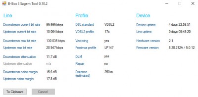

B-Box 3 Sagem Tool v0.10.2
Downstream current bit rate:   100.000 kbps
Upstream current bit rate:     10.064 kbps
Downstream max bit rate:       135.302 kbps
Upstream max bit rate:         27.808 kbps
Downstream attenuation:        7,9 dB
Downstream noise margin:       17,6 dB
Upstream noise margin:         17,0 dB
DSL standard:                  VDSL2
VDSL2 profile:                 17a
Vectoring:                     yes
Proximus profile:              LP147
DLM:                           yes
Repair:                        no
Distance (estimated):          136 m
