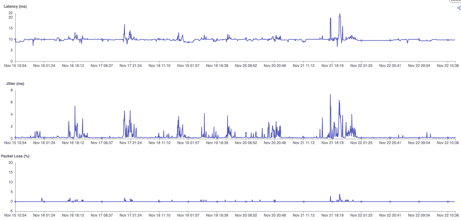

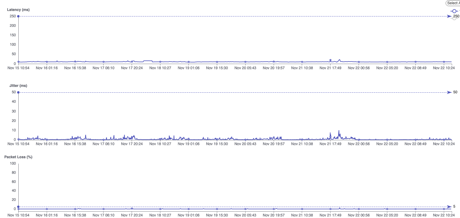

Hier de laatste week qua latency/jitter/packet loss richting cloudflare dns:
richting edpnet next hop:
