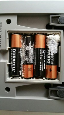

Voor mij geen Duracell batterijen meer! Die lopen vaak uit.
De onderstaande foto is genomen op 27/11/2016. De batterijen liepen nog tot maart 2018. Ze waren dus zeker niet 'over tijd'.
Toen ik contact nam met de fabrikant en de foto's doorstuurde zei die doodleuk aan de telefoon: 'dat kan gebeuren mijnheer'.

Dat leeglopen, is een effect dat gebeurt bij volledig lege batterijen.
Dergelijke Alkaline types van alle merken, lekken vaak als ze volledig ontladen zijn.
https://en.m.wikipedia.org/wiki/Alkaline_battery
.All batteries gradually self-discharge (whether installed in a device or not) and dead batteries will eventually leak. Extremely high temperatures can also cause batteries to rupture and leak (such as in a car during summer) as well as decrease the shelf life of the battery.
The reason for leaks is that as batteries discharge — either through usage or gradual self-discharge — the chemistry of the cells changes and some hydrogen gas is generated. This out-gassing increases pressure in the battery. Eventually, the excess pressure either ruptures the insulating seals at the end of the battery, or the outer metal canister, or both. In addition, as the battery ages, its steel outer canister may gradually corrode or rust, which can further contribute to containment failure.
Once a leak has formed due to corrosion of the outer steel shell, potassium hydroxide absorbs carbon dioxide from the air to form a feathery crystalline structure of potassium carbonate that grows and spreads out from the battery over time, following along metal electrodes to circuit boards where it commences oxidation of copper tracks and other components, leading to permanent circuitry damage.
The leaking crystalline growths can also emerge from seams around battery covers to form a furry coating outside the device, that corrodes any objects in contact with the leaking device.

Energizer geeft bij mijn weten effectief garantie tegen lekken. Metalen apparaten waarbij de batterijen achter elkaar zitten, kunnen wel eens finaal onbruikbaar worden door een lekkende batterij. Ik denk hierbij bv aan een Maglite zaklamp of een Apple keyboard. Als je dat aan de hand hebt met een Energizer batterij, betaalt Energizer je het apparaat (en de batterij
) terug.

In de USA
http://www.energizer.com/about-batterie ... -guarantee
In EU: niet terug te vinden!!
https://energizer.eu/battery-history/
