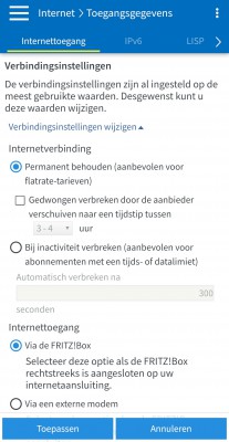

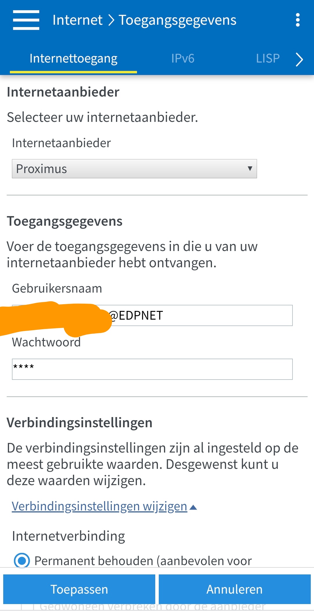

Hi guys,
Sorry for writing in English. Wonder if you can help me out. I recently moved to Belgium, have Proximus internet, no TV, and I want to use my Fritzbox 7350 instead of the bbox. When trying to connect to DSL the fritzbox tells me the connection failed and I should check the cable connection (or similar). So it does not seems to get a valid signal at all. DSL does work flawlessly on the bbox however.
What could be wrong? I tried both Annex A and B. I selected Proximus. I entered the user and password. Tripple-checked everything. I understand from reading here that I need the correct firmware. My fritzbox is on 7.13. Could this be an issue?
Sorry if I missed something really basic, or I misunderstood and this will not work for some reason.
Adding the fritzbox with a second IP range next to the bbox is not an option. I really would love it standalone. It is a shame this has to be so difficult. I am from Germany and thankfully over there we regulated this is the right direction. An internet provider should have no business in limiting how your local home network gets set up.

I guess you are talking about the FritzBox 7530 (7350 does not exist)Woody76 schreef:So it does not seems to get a valid signal at all. DSL does work flawlessly on the bbox however.
- It shoud work "out of the box" (country Belgium, Provider Proximus).
- Annex A or B does not matter, unless you are connected to a Ikanos DSLAM (non-vectoring). Hence better choose Annex B if unknown!
- user and password does not matter: you should always have a good DSL sync (even with the wrong credentials).

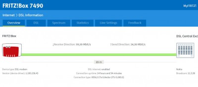

Mijn FritzBox 7490 heeft zich deze nacht zelf ge-updated naar 7.21
Previously used: FRITZ!OS version 07.12
Now installed: FRITZ!OS version 07.21
Version (device driver): 1.100.136.43
Snelheid tot nu toe 100/30 bij EDPnet op een kleine 300 meter van de ROP.

Niet te veel vragen bij stellen. Mijn FB staat al maanden op 07.21. Update manueel gedownload van de FTP server en dan geïnstalleerd. Indien probs met VDSL, gewoon previous driver aanvinken.johan.devos schreef: Ik zie op de AVM FTP server nochtans geen 7.21 bij België en ik dacht dat deze versie nog niet vrijgegeven was voor Belgie?

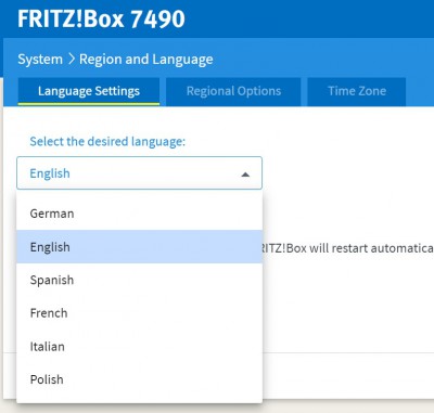

johan.devos
- Berichten: 1402
- Locatie: Bevergem :-)
- Bedankt: 184 keer
Land België
Taal English
Geen previous driver
Automatische update zonder manuele request of confirmatie
Alles loopt nog altijd vlotjes, geen fallback tot nu toe
Taal English
